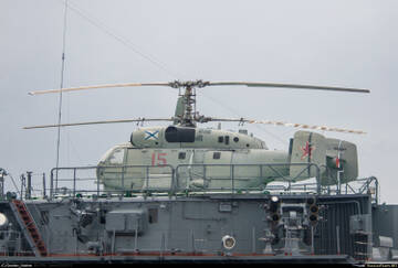

https://russianplanes.net/id306157
http://forumupload.ru/uploads/0000/d0/8c/2718/t306157.jpg

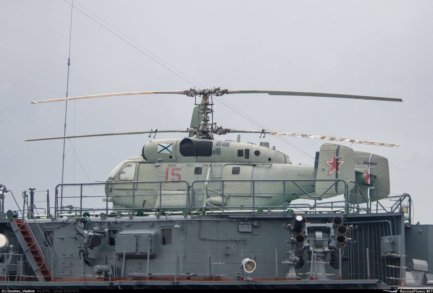

https://russianplanes.net/id337273
https://forumupload.ru/uploads/0000/d0/8c/2718/t337273.jpg

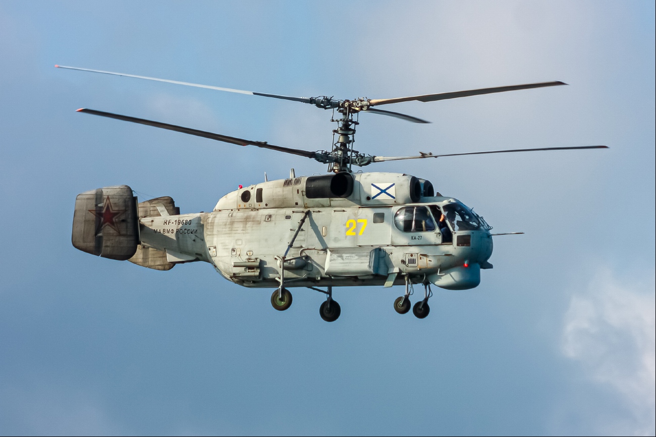

https://aviapix.ru/photo/28568/
https://forumupload.ru/uploads/0000/d0/8c/2718/t28568.jpg
